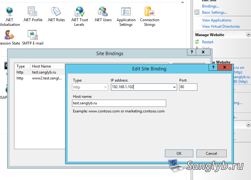

Next, we register a new server address in the hosts file on your computer. We detach the site in the browser. I specifically wrote that you need to open a site in the browser before changing the bindings in the settings of the site, to make sure that we went to the correct server. In general, the default site should open.
After that, you need to go to the settings of our site and change the bindings.
Again, go to the browser on our computer and update the site, we should open our site on the new server. We check that everything would work (it’s convenient to use Chrome with the developer mode enabled). If everything works then we change records on DNS servers, everything is ready. After the DNSs are updated, you can stop the site on the old server.
